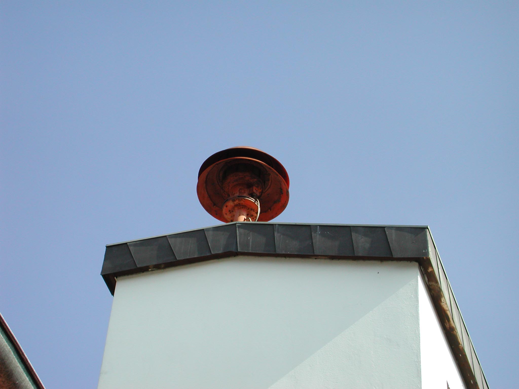

Siemens Sirene in Griechenland
orestis
Beiträge: 150
Beitrag von orestis »
This siren must be very old... It is installed on a city hall in Pallini. I know that most of these sirens were installed in Greece before WWII. Can you tell - when Siemens stopped producing these sirens?

Hello Orestis,
have many thanks for your nice and detailed pictures !
Is this siren still in operation? The cable looks like it is, or ?
Very interesting the technical data. I wouldn't believe my eyes
when I was reading the current / power data:
220/380 V 25/14,5 A 5 kW
For comparison, the data of our later German standard
air raid siren E-57 are:
220/380 V 15,5/9 A 5 kW cos phi (power factor) 0,85
Therefore, power factor of this old WW II Siemens siren must be
very, very poor ... nearby incredible !
Please calculate: 220 V * sqrt 3 * 25 A = 9,5 kVA
equal: 380 V * sqrt 3 * 14,5 A = 9,5 kVA
so, power factor of this siren motor is only about 0,5 ... very low for an
induction three phase asynchronous motor. Never heard so before.
"5 kW Aufn" means 5 kW input, so, there are no motor losses included.
By the way, same type of siren is installed on the roof of an old fire house
in Bad Homburg, near by Frankfurt / Germany, about 5 km away from
the town where I live. But, this siren is out of operation since a long time.
For pictures see thread:
"Kurios in Deutschland" ---> "Die letzte verbliebene Sirene in Bad Homburg"
The type number "L 135" perhaps may indicate the year of introduction.
This would be 1935 ... in Germany in former times it was usual, to call
objects after the year of their invention, for example "gun model 98"
for year of introduction 1898, or "MG 42" for 1942, and so on ...
Have fun and best regards !

I believe this siren is still in working order. You 're right about the outpout! I didn' t notice before you tell me. I thought this siren type was FMSI39, what do you think? In Greece we have lots of them.
I assume -from pictures seen in the forum- in Deutschland more common type is the FMSI40 (?) which is dual tone, for fire alarms and air raid. (Whith three "schutzdach") In Greece we have no such sirens since we don't use fire alarm.
It's true usually numbers stand for year of invention. But FMSI40 was first produced in 1934 so the type name is not always indicating the year...
However NEVA55 is another example. The production of this siren started in 1955...
I wonder when Siemens stopped producing these sirens as to estimate how old are in total. It's possible we continued buying them after 1945 when war ended.

Habe den Beitrag leider erst jetzt entdeckt!
Hier liegt ein schon oft gesehener Irrtum vor!
Der cos phi gibt lediglich den Anteil der Wirkleistung an der Gesammtleistung an.
Der Rest ist die Scheinleistung.
Eine so hohe Scheinleistung entsteht durch die gewaltige Menge an ferromagnetischem Material in Motoren dieser Zeit, die erstmal magnetisiert werden muss.
Der gewaltige Stromfluss der dadurch entsteht und die darauf folgende Änderung des Magnetfeldes dürfte auch der Grund sein, warum die FM SI 41 trotz viel schwereren rotierenden Teilen viel schneller hochläuft (siehe die FM SI 40 in Rheinböllen) als die (Induktionsgesetz: Induktionsspannung=Änderung des magn. Feldes / Zeitspanne)
Auf keinen Fall darf die Scheinleistung mit der Verlustleistung verwechselt werden!
Die Verlustleistung ist das was am ohm'schen Wiederstand der Windungen verheizt wird, und die Verlustleistung ist NICHT gleich der Scheinleistung!
Die Scheinleistung ist die Energie, die im magn. Feld der Windungen "gespeichert" wird.
Bei der nächsten Periode fließt diese in's Netz zurück.
Ich kann mir auch vorstellen dass die beiden Motoren den größten Teil der 180kg ausmachen, die die FM SI 40 auf die Waage bringt
